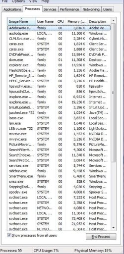

My norton 360 trial just expired. Ever since then the computer was really slow. It took me 1 hour to uninstall it. It even ran slow in safe mode. I figured this was the issue b/c I tried to use system restore and it could not fuction b/c of antivirus. So i deleted norton and now it seems a little faster but not much. what else could be the issue? I can't give you a screen shot b/c the task manager

sorry it is going so slow, it is hard to manage
