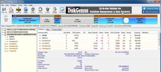

windows disk mgmt says
diskgenius can see the partitions

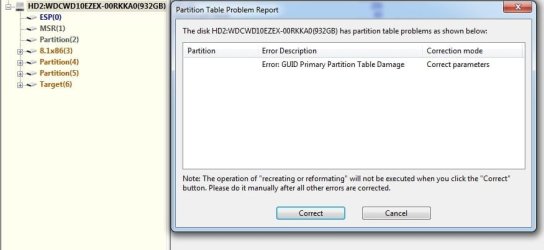

diskgenius has detected a problem which it offers to fix.
Click Correct

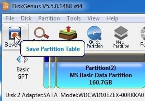

click Save

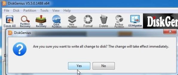

confirm
and there you go
