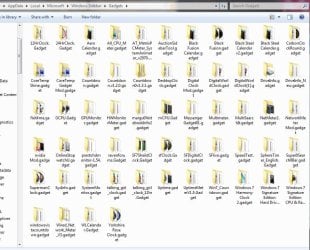

hi Shaks, i found the solution my self. the problem is a gadget which is corrupted, so what i did is deleted all the downloaded gadgets now the defualt gadgets work good.
go to start, search for Shell:gadget and open it delete all the files or try deleting one by one so that after you delete one you can check wheather side bar is working or not if not then delete all and check this should really work.

its shell:gadgets am sorry for the mistake
