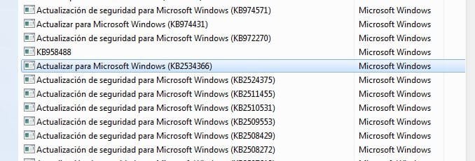

Is Update for Microsoft Windows (KB2534366) installed ?

2. It says update KB2534366 is installed.

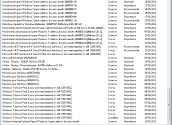

Another thing that might be important is that it seems that the first install of SP1 was cancelled. At least it says so in the Update history which I attach. I have no conciousness of shutting down the computer while it was installing it, ...but it might have happened.

Thank you for posting the Installed Updates list.
AVG Free 2011 includes an antispyware component. Which means that Windows Defender should not be running nor updating it's definitions.
Yet, on May 17th, there's an entry showing it doing just that, updating it's definitions.
How long ago was AVG installed ?
Which antivirus program was replaced by it ?
