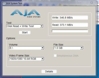

Hi! I have several computers connected to a file server using direct 4Gbit fibre (facilis 24tb Terrablock - 24 1TB drives in raid 5) connections, and using testing tools to test speed of the mounted volumes I get about 400 MB/sec, and using the utility to copy files given by Facilis, I can copy files from and to the served at about 400 MB/s, but when I use windows expoler, speed goes down to only 25MB/s and I'm observing this behavior in all the computers where Windows 7 is installed, one old computer running windows XP does not have the problem, MACs with OSX does not have the problem either.
Any clues why this can be?

The device I'm reading from have 24 Drives in RAID as I explained on my first post (facilis 24tb Terrablock - 24 1TB drives in raid 5) so I'm actually have a lot more than 400MB/sec speed on the source drive, it just the bottleneck of the 4Gb fibre card what is limiting me to read 400 MB/s. And I'm getting that speed too on Windows 7, but with some proprietary tools and specific applications, but as soon as I try to move files or copy files with Windows explorer, I never get more than 25 MB/sec, from the same drive. If I use a 3rd party tool to copy files, all goes at maximum speed.
