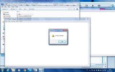

Hi got as far as locating CBS but then get the message access denied?

HI Quovadis,
what about the other report,
and as you cant get into CBS--
hit by malware lately or been changing any registry keys or permissions??

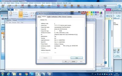

Hi Roy , run the previous software as requested I will upload you to screen shots if this helps
regards Paul

Hi Quo,
can i see the whole report please, im searching for clues.
Roy

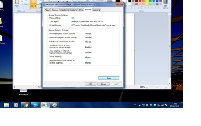

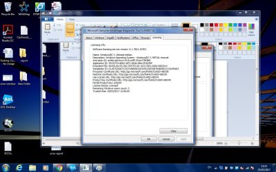

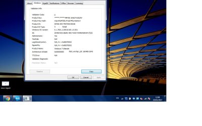

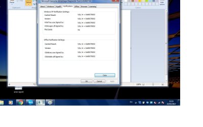

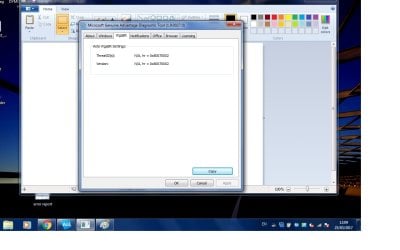

Hi Quo,
in regard to the clean install
W7 comes driver ready, if ones not there it will provide generic ones.
then goto the homepage for that make model, as the link comes bloatware free, ONLY install the updater utility.
As i said post the complete Mgadiag, the key, although its retail, could be tied to a 3rd party server.
Take about a couple hours max to complete,
note follow Tharshzone comments post #2 here

Hi Quo,
I assumed it was the 64Bit version, thats what the link was, but as your only running 2GB memory
WAY to little for 64, pushing it for 32 as well
please comfirm 32 bit, link below
https://software-download.microsoft...1490550680&h=ac2ea814ebedc9f43506225d4f21ce79
note as the licence is Retail it can be used on ANY computer
Roy
Post #5, Niemiro's tool see's it as x86

Thanks Derekimmo missed that.
Must have posted the wrong link:confused:.
The max RAM on that machine is only 2GB, as i said in my last post its not man enough for 64bit and is HIGHLY likely thats why it was acting up, and thrown in the cupboard:geek:
Quo your best bet is a clean install with the 32bit, still might play up
Looking on the bright side, as i said its Retail you can use it on any comp, de-licence it first
Roy
