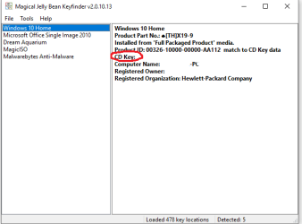

Repair Install is simple. You do it from within windows, i.e. while your computer is running. Brian's video is excellent!
Make sure you have your 25-character key. I use magic jellybean to find it (see screenshot below). I usually download the Win7 ISO, & extract it with 7-zip to a folder on my desktop. I open the folder and run setup.exe. When you get to the screen that gives you two choices, you want Inplace Upgrade
