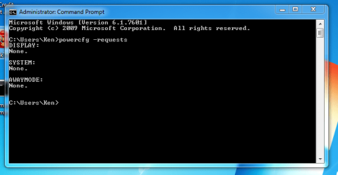

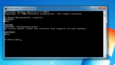

For some reason one oif my W7 systems will (sometimes) not go to sleep automatically (after the set delay time). It seems if I go in and change something it will work for awhile and then stop working for no apparent reason. The main issue is using WHS 2011 which wakes all the computers on the network in the middle of the night and does it's thing and then then the computers go back to sleep after the set delay untill needed in the morning.
Every time I find this computer not sleeping I run powercfg -requests and every time there is a request - see attached screen capture. On the other hand every time is is working properly there are no open requests. I think this is the issue but I need help trying to figure out who has the request and what to do about it.

You might try running "powercfg -requests" from the Prompt Command window when the system should be in the S3 State. That is what gave me a hint of what was keeping my problem system from occasionally not entering the automatic sleep state.

Thanks Ken, your tip on using powercfg -requests was what helped me find out the problem. My wife tried to print something from her computer 10 days ago, right when the not going to sleep problem started and there was an error within the printer driver.
Before I could use powercfg -requests I had to search around to get Administrator access to my normal command prompt. I don't have a 'run as admin' on my shortcut menus, and I run UAC at one level lower than standard. Nothing was working, after trying for about 2 hours I guessed you turn UAC off in win7 by just lowering the slider all the way down, but they don't really say that. Then you need to reboot.
Finally my normal command prompt worked and gave me the info I needed.
I had been suspecting some new DirecTv stuff I loaded about 2 weeks ago also, so I was removing that, running the computer without network access, getting rid of MS Media Center, trying to eliminate things that might be causing access.
Then with the powercfg -requests I spotted it immediatly. So all in all about 2 days on this issue. I had wondered at the time what happened to my wife's print jobs, as all else seemed to be working fine, including the occasional printing I do.
