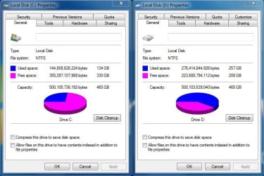

Can we get a picture of your disk management control panel uploaded?
How big is the "D" partition, and how big is "C"?

Here is the screenshot you asked for as well as a screenshot of the Properties for both hard drives.
