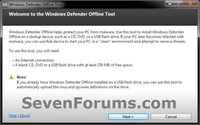

2. Run the downloaded mssstool64.exe (64-bit) or mssstool32.exe (32-bit) file, and click on Next. (see screenshot below)

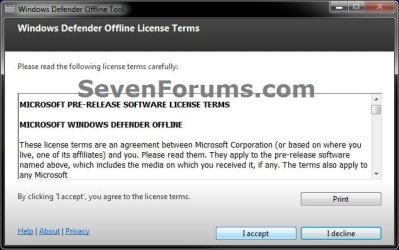

3. Click on the I accept button. (see screenshot below)
NOTE: You will only be prompted for this the first time that you run the Windows Defender Offline Tool.

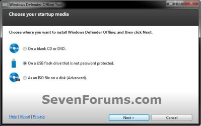

4. Do step 5, 6, or 7 below for what type of bootable "Windows Defender Offline" CD/DVD, USB, or ISO that you would like to create to scan with. (see screenshot below)

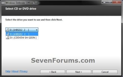

5. To Create a"Windows Defender Offline" Bootable CD or DVD
A) Insert a blank unformatted CD or DVD into the CD/DVD drive.
NOTE: If a AutoPlay window opens afterwards, close it.
B) Select (dot) Use a blank CD or a DVD, and click on Next. (see screenshot below step 4)
C) If you have more than one DC/DVD drive, then select the CD/DVD drive with the blank CD/DVD in it, and click on Next. (see screenshot below)

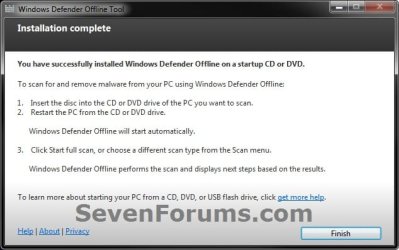

D) When it's finished, click on Finish. (see screenshot below)
NOTE: Be sure to label the CD/DVD as being able to only be used on a 32-bit or 64-bit Windows computer at boot.
E) Go to step 8.

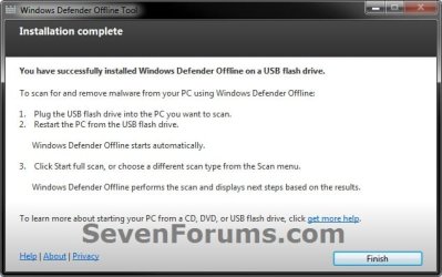

6. To Create a "Windows Defender Offline" Bootable USB Flash Drive
   Note
If you run the Windows Defender Offline Tool again on the same USB flash drive, and if the following conditions below are met, the tool will only download new updated malware definitions (approx. 69.48 MB) and update the USB drive without reformatting it.
  • The USB flash drive has Windows Defender Offline previously installed on it.
  • The Windows Defender Offline Tool version that was used to create the bootable USB flash drive the first run is the same as the one being used for the second run.
  • Files on the USB flash drive are not damaged or missing (the tool will verify that).

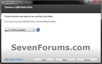

A) Connect a USB flash drive that is not password protected to your computer.
WARNING: This USB drive will be formated during this process, so be sure to backup anything that you do not want to lose to another location first.
B) Select (dot) On a USB flash drive that is not password protected, and click on Next. (see screenshot below step 4)
C) If you have more than one USB drives connected, then select the one that you want to use, and click on Next. (see screenshot below)
E) Go to step 8.

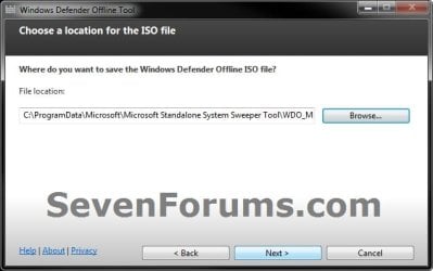

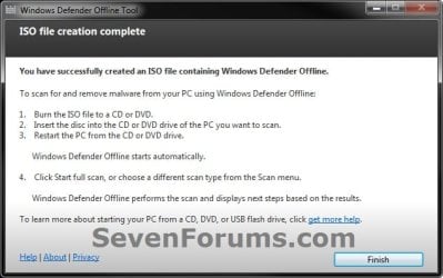

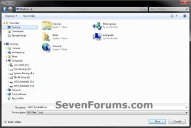

7. To Create a "Windows Defender Offline" Bootable ISO File
A) Select (dot) Create Standalone System Sweeper on an ISO File, and click on Next. (see screenshot below step 4)
B) Select (browse) where you would like to save the ISO file to, and click on Next. (see screenshots below)
C) When it's finished, click on Finish. (see screenshot below)
D) You can now use the ISO file to boot with in a virtual machine (ex: Windows Virtual PC), or use the free Windows 7 USB/DVD Download Tool to burn the ISO to a DVD or USB flash drive.
E) Continue on to step 8.

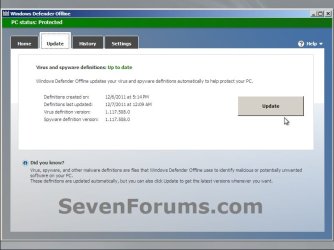

4. When Windows Defender Offline has booted, you will be able to update the definitions and select what type of scan you would like to run on the computer. A Full Scan is recommended, and could take several hours to complete.
NOTE: You will only be able to update the definitions at boot if you are using a bootable USB flash drive with a internet connection, and not with a bootable CD/DVD.

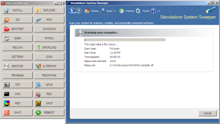

I found the ISO useful to run at boot on a virtual machine (ex: Windows Virtual PC) to scan it. You can just select the ISO file to act as a "DVD Drive" in the VM's settings to boot from.
Hopefully, this tool will be improved prior to its final release. One thing that I feel needs to be addressed is the 32-bit/64-bit issue. It might be fine for those of us who only have one OS installed, or only have OSes of either 32-bit or 64-bit architecture (but not both). What about those of us who, like me, have both?

Great tut, again thanks.
As soon as I saw this, was hoping it was available in an ISO file.
Will add this to my rescue USB tool.
I'm glad you are happy with the ISO option. We were hoping it would be of use.
However, if you prepare the ISO now and keep it aside, it will not be up-to-date by the time you are using it (hopefully never :) ).
I have two suggestions for you:
  1. Since the tool will reformat your USB, backup your rescue USB drive and create a bootable USB using the tool (you can then copy your data back onto the USB drive), and add the tool binary as well. By the time you have to use, it run the tool again with the same USB drive. The tool will detect the already installed product and will only update the definitions (without reformatting or altering your data).
  2. The second option is indeed to keep an ISO and when the day comes use Brink's option #1 of manually updating the definitions.
    Please keep in mind that the latter option is not currently supported or intended by Microsoft. Use it at your own risk.
Thanks,
Guy.
Thank you for the reply.
Haven't tested it yet, but would like to know if the ISO version is the same as the CD/DVD and USB version?
Reformats the entire USB drive when opened?
I agree the vast majority will install this on a clean USB or CD/DVD for one time use, but many of us would like the option to install it as a program ISO in order to add it an existing USB multi tool device.
In program updating would be the preferred option but, re-D/L'ing and adding to the USB tool would be fairly simple once it is setup.
One of my USB multi tool device has bootable files with an editable program list, which allows adding any ISO file program. Then when booting to the device you can select the program you want to run. I have several small programs installed on it and it can also still be used for any other file storage.
This makes the tool very useful and time saving, and excellent trouble shooting device.
My favorite multi tool is a PE based device that you can add programs to, very useful as it allows much more flexibility. This would benefit greatly from the in program update function.
As mentioned, 'no sense in having boot media with only one function', when it is possible, and many available methods, to make a multi tool device.
These are just some suggestions that I hope MS can consider for this useful program.
I'm not sure I completely understand your question. Let me try to organize things a bit:
The tool, once downloaded and ran on your machine will enable to choose between create a bootable CD/DVD, USB or creating an ISO file (which can later be burnt or mounted to a VM and used as bootable).
The tool requires your optical media (CD/DVD) to be blank, and your USB drive with at least 250MB of space.
In case you select the USB option the tool will reformat the USB drive on the first run only. Subsequent runs of the tool with the USB drive and same version of the tool will only update the definitions on the USB drive without reformatting it (after verifying the files on the USB drive).
The all bootable media created contain the same version of data. The bootable data doesn't contain any action to format or alter information on your hard drive (unless remediating infected files of course). Only the tool used to create the bootable media could formats the USB drive (but only if used to create a bootable USB dirve, not if used to create an ISO file).
:warn: Please note that the scenario you are describing is not supported by Microsoft and the advise I'm giving is voluntary only.
I hope that answers your question,
Guy Arad.
Windows 7 Enterprise x64 SP1
Thanks again for the reply, I think you answered my question.
One bootable flash drive tool I'm using is the Corsair Bootable USB Flash Drive, the boot files are on the USB Flash Drive root.
You can add any ISO program file, edit the boot menu and it will be added to the list on the opening page, the ISO files run from there.
Was hoping I could add MSSS to this USB Flash Drive tool.
From your explanation the ISO file will not format the USB drive and is an ISO program file, so this should work.
I will test it and post the results here.

Hi Dave,
Pretty sure it will be fine to boot mms iso from your menu, just like any other .iso
