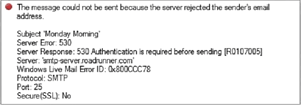

Windows Live Mail 2012 error code 530 0x800ccc78 --
chevytech
1:07 AM
8
Wlm was working perfectly--past week won't send or receive emails. Server settings for ISP TWC Roadrunner match my upstairs desktop with Outlook Express 6---it works fine. Called Microsoft to find it is a known problem a lot of people are having & the Fee to fix their glitch would be $99. I refused & was told a reinstall of Windows essentials would not solve it. Is there such a thing as a "clean install" of the program ?
Any thoughts on this appreciated.

Welcome to Seven Forums Roger. This is a send problem? Or send and receive? Give us as much info as possible, you try to do x, and receive so and so error, etc.
Try this, and see if it works. Boot to Safe Mode with Networking, and try there.
http://www.sevenforums.com/tutorials/69585-safe-mode.html
If it works there, try a clean start and see if it works there
http://www.sevenforums.com/tutorial...ation-conflicts-performing-clean-startup.html
You could have a security program, or another 3rd party program blocking. That error, according to MS:
0x800CCC78 IXP_E_SMTP_REJECTED_SENDER Unknown sender (This error occurs because you have the incorrect e-mail address in the Reply-To field)

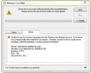

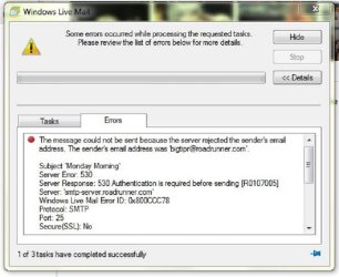

Error Message 530
Here is the Message i get after opening WLM2012---will try your suggestions A Guy---thanks for the help.:) OK--so i booted up in Safe Mode w/Networking & WLM 2012 wouldn't start & i got this message.
Have tried disabling the Mcaffee firewall & have set it to not monitor WLM at all---reopened Mail & still have the problem.
Used the "uninstall program" from control panel & removed entire package of Windows Live Essentials---even looked at C:program files/windows live & in common files----32 bit Windows 7----those 2 files were gone in uninstall. Downloaded Windows Essentials 2012 & installed---WLM still won't work. Was the way i uninstalled the program the best way to completely clean old files out ?

Is it still Roadrunner, or has it changed? Can you sign in to the Roadrunner webmail directly using the same email address and password you use through WLM? The server seems to bejecting your email address, but doesn't really say why.

A-Guy, Thanks again---went to Roadrunner Mail & logged in perfectly,received emails---so my problem is not with the ISP service provider ?
Also tried changing port #s to 587 & 995 on my account properties---still no luck.

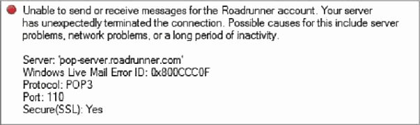

Glad to hear the TWC servers solve the issue.
Both errors you received were Server errors. Your mail servers then were:
pop-server.roadrunner.com
-- and --
smtp-server.roadrunner.com​
It's possible that TWC is making changes or some network configuration forgot about smtp-server.roadrunner.com (it does happen)
