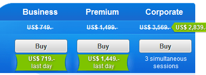

Wow. On-site support. That has got to cost a pretty penny.
You might ask your boss about purchasing some remote control software. TeamViewer is very expensive, but at least you only pay once. There are several other remote control options out there. UltraVNC is free, but requires some work to use it in a secure fashion. i would not use the server mode for unattended remote access.
I wonder what the price of TV will be after today :-)
