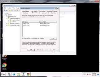

In DNS Manager from your Win08 Server, right click on the Server Name, choose Properties, locate Forwarders Tab and add the DNS Resolvers here. If you don't know those DNS's you may call your ISP.
My ec.rr.com Road Runner DNS are:
DNS 1
209.18.47.61
DNS 2
209.18.47.62
Not sure when I press right click, which option I should choose.

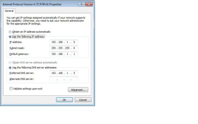

You have to right click on 'SERVER', that's your Server Name, according from your print screen?
Then follow the rest of my instruction, then add those DNS's in Forwarders Tab.
BTW..you Server's TCP/IP screen looks good now. :D

Alright.. this is what I got in the properties field.
I will test everything to see if its working.
Just want to verify everything;
Server:
IP: 192.168.1.5
Subnet: 255.255.255.0
Gateway: 192.168.1.1
DNS: 192.168.1.5
Computer 1:
IP: 192.168.1.2
DNS: 192.168.1.5
DNS2: 192.168.1.1

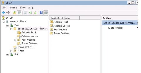

Both client computers need to have DHCP enabled, it shd auto assign IP's correctly coming from your server. Are you doing Fixed IP?
DNS2 - Wrong - just remove it, you don't need it.

I just put it to DHCP
Do you have any idea why I am getting these DNS servers:
208.67.222.222
208.67.220.220
even though I forced my Road Runner DNS servers on the server itself.

As long as is showing the Server's DNS, that's fine.
You shd also check the Event Viewer for any DNS Errors.
Have you tested your GPO? You may just do gpupdate /force on the user's computers to see if your GPO works.
WSUS - do a manual force WU, see if it works this time.
