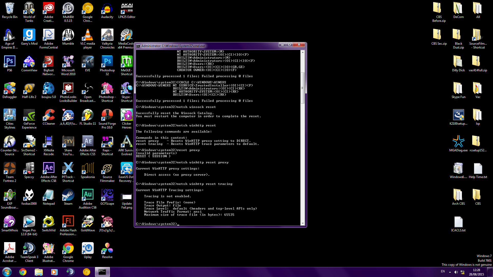

CheckSUR found no problems - the report is dated 2015-08-27 19:20 (which is after your first post here?)
In view of the history, lets have a look at permissions....
Open an Elevated Command Prompt, and run the following commands
ICACLS C:\Windows
ICACLS C:\Windows\System32
ICACLS C:\Windows\SysWOW64
ICACLS C:\Windows\winsxs
Post the results
Once you've posted the results,
NETSH WINSOCK RESET
NETSH WINHTTP RESET
reboot
post another MGADiag report.
ICACLS C:\Windows
Post the results
NETSH WINSOCK RESET
NETSH WINHTTP RESET
reboot
The Sur was the one that came with the cbs that ruined the computer. I have a more up to date one if you want that. I'n the mean time I will be posting the commands.

Microsoft Windows [Version 6.1.7601]
Copyright (c) 2009 Microsoft Corporation. All rights reserved.
C:\Windows\system32>ICACLS C:\Windows
C:\Windows NT SERVICE\TrustedInstaller:(F)
NT SERVICE\TrustedInstaller:(CI)(IO)(F)
NT AUTHORITY\SYSTEM:(M)
NT AUTHORITY\SYSTEM:(OI)(CI)(IO)(F)
BUILTIN\Administrators:(M)
BUILTIN\Administrators:(OI)(CI)(IO)(F)
BUILTIN\Users:(RX)
BUILTIN\Users:(OI)(CI)(IO)(GR,GE)
CREATOR OWNER:(OI)(CI)(IO)(F)
Successfully processed 1 files; Failed processing 0 files
C:\Windows\system32>ICACLS C:\WINDOWS\SYSTEM32
C:\WINDOWS\SYSTEM32 NT SERVICE\TrustedInstaller:(F)
BUILTIN\Users:(RX)
C:\Windows\system32>ICACLS C:\WINDOWS\SYSWOW64
C:\WINDOWS\SYSWOW64 NT SERVICE\TrustedInstaller:(F)
BUILTIN\Users:(RX)
C:\Windows\system32>ICACLS C:\WINDOWS\WINSXS
C:\WINDOWS\WINSXS NT SERVICE\TrustedInstaller:(OI)(CI)(F)
BUILTIN\Administrators:(OI)(CI)(RX)
NT AUTHORITY\SYSTEM:(OI)(CI)(RX)
BUILTIN\Users:(OI)(CI)(RX)
BUILTIN\Users:(RX)
BUILTIN\Users:(RX)
BUILTIN\Users:(RX)
