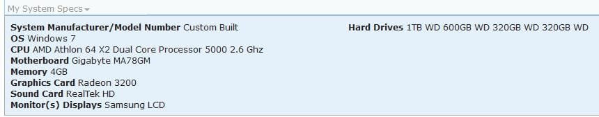

What made you think my PC was custom built, I never mentioned that? It's a Dell All-in-One that was shipped directly from Dell, so I'm not too concerned about where the OS came from. Test Mode was not enabled when I received it a year or so ago. It was just recently I noticed it, and it was a coincidence I noticed it after only finding out I had CryptWall 3.0 ransomware on my computer. I never enabled Test Mode, so I figured my system at some point became compromised and the Test Mode was enabled by malicious code or similar. I mean how else could it? It doesn't enable by itself; Microsoft clearly states on 64bit machines it is not enabled by default.
Perhaps the information you entered in your System Specs??

I thought it was a custom build as thats what you've got on your CP
