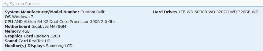

Seriously, Factory install is the worst possible install of Win7 one can have, as bad as being badly infected. Avoid this and all other problems by doing a perfect Clean Reinstall Windows 7 which will stay that way as long as you stick with only the steps, tools and methods given. Over 1.5 million consumers have used the tutorial without a single complaint. They have the best installs of WIn7 in the world. You have the worst. Next will come the locusts.
I did read your complete post and that includes the last line.
From the tutorial.
This test mode may occur if an application whose drivers are not digitally signed by Microsoft is installed and still in the test phase.
What made you think my PC was custom built, I never mentioned that? It's a Dell All-in-One that was shipped directly from Dell, so I'm not too concerned about where the OS came from.
Perhaps the information you entered in your System Specs??

I thought it was a custom build as thats what you've got on your CP
