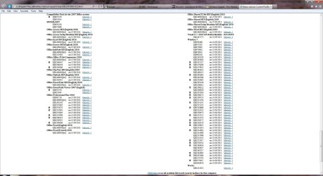

Can I suggest a link to Belarc Advisor? It lists all the downloaded updates and clicking the details link for each one link takes the user to a Microsoft page that gives a comprehensive insight into what the update is for.
I am always willing to accept suggestions. I have very little experience with Belarc. I shall have a play later. Where do you think it is applicable in this and/or another tutorial, and I shall consider carefully :)

I mentioned Belarc in the context of what each update is for.
People very often download updates without knowing whether they are relevant to their system.
The details link at the side of each update that Belarc lists goes some way in suggesting the purpose of them.
