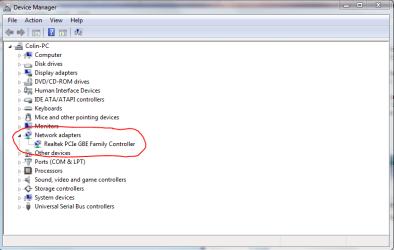

Can you please post an image similar to one below showing your wireless adapter? In Start < type device manager, and then select it.
