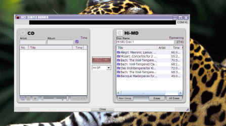

Here's a Minidisc application on an XP VM - the Host doesn't even KNOW about Minidiscs. As a test I'm running this XP VM on a WINDOWS 10 X-64 HOST.
