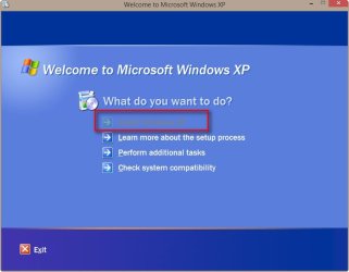

It is totally OK the Install Windows XP being grayed out when you start Windows XP install program on your Windows 7. it should be grayed out. Your Windows 7 can naturally not be "upgraded" to XP, so when you launch XP setup from Windows 7 desktop, the install option is disabled as the XP setup notices that you already have a more recent Windows installed.
This is how it should look if the Windows XP setup program is launched on newer Windows (Vista, Seven or Eight):

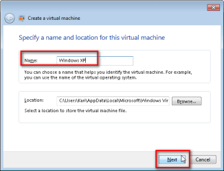

However, if you want to give it one more try, here's a simple illustrated mini tutorial especially for you:
  • After you have installed the Windows Virtual PC, open the Virtual Machines folder at C:\Users\Your_Username\Virtual Machines. Click Create Virtual Machine:
  • Name your virtual machine (vm) as you wish, click Next:

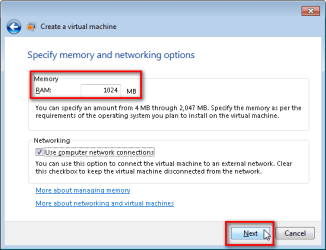

  • Allocate enough RAM to your vm. My recommendation: if you have 2 GB of RAM on your host, give the XP vm 512 MB. If you have more than 2 GB on host, give the vm 1 GB (1024 MB). Click Next:

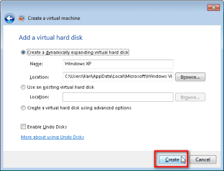

  • System selects by default a dynamically expanding vhd (virtual hard disk). Accept it by clicking Create:

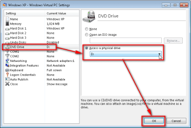

  • Now right click your newly created vm and select Settings:
  • Select DVD Drive on the left pane, select Access a physical drive and select the drive that has your windows XP CD in it from the drop down menu, in this example the drive D:. Click OK to save settings:

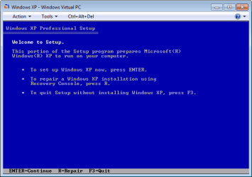

  • Double click your vm, in this example Windows XP.vmcx, and the Windows XP vm starts, setup starting automatically. Notice that this can take some time, do not panic if the black window stays there a minute or so. Eventually the setup starts:
  • Install XP normally as you would do on any PC.
