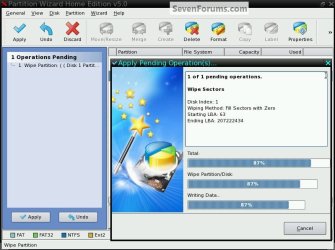

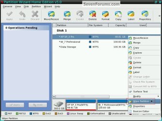

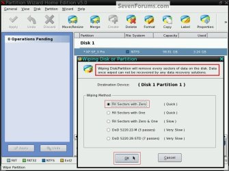

1) In the Partition Wizard program, right click the XP partition (the first partition) and click "Wipe Partition", in the dialog box that opens select the type of wipe you want to run and click OK.
Partition : Recover Space Used by an Older OS-wipe.jpg
Partition : Recover Space Used by an Older OS-wipeselect.jpg

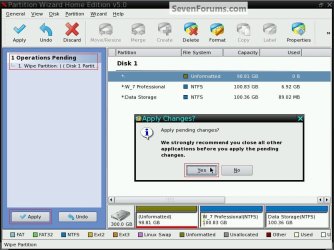

2) In the left pane at the "Operations Pending" column click Apply then Yes to the 'conformation' dialog box.
Partition : Recover Space Used by an Older OS-wipeapplyyes.jpg
3) You will get a progress graph, when it is finished click OK for the 'successful' dialog box.
Depending on the size partition you do the wipe to it could take a considerable amount of time, to wipe this 98+GB partition it took just over 30 minutes, just relax and let it finish.
Partition : Recover Space Used by an Older OS-wipepending.jpg

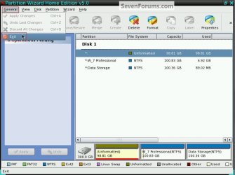

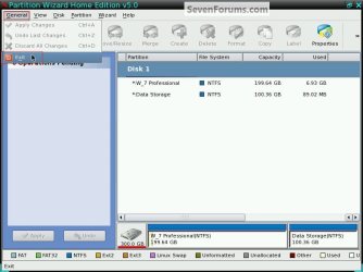

4) It would be a good idea to boot into Windows 7 to let it recognize the changes to the partition structure and make sure all is well before you go on to the next step.
Remove the PWBD from the ODD and at the upper left corner at "General" click "Exit" to close the Partition Wizard program and start Windows 7.
Partition : Recover Space Used by an Older OS-wipeexit.jpg

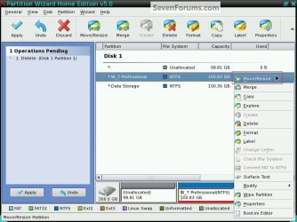

1) Right click the space from the old XP partition and click delete, you will see an entry added to the "Operations Pending" column but don't click apply yet.
Partition : Recover Space Used by an Older OS-delete.jpg

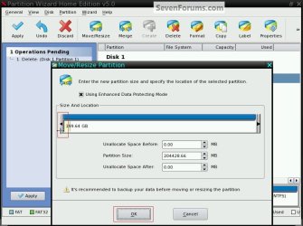

2) Now right click the Windows 7 partition and click "Move/Resize", in the dialog box that opens click and hold to drag the left slider so that there is no "Unallocated Space" before or after the Windows 7 partition and click OK.
Partition : Recover Space Used by an Older OS-resize.jpg
Partition : Recover Space Used by an Older OS-resize2.jpg

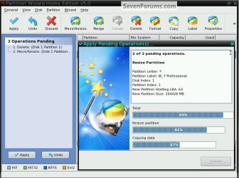

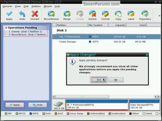

3) Now in the left pane "Operations Pending" column click Apply and then Yes to the 'conformation' dialog box.
Partition : Recover Space Used by an Older OS-resizeapplyyes.jpg
4) You will get a progress graph, when it finishes click OK for the 'successful' box.

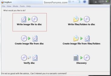

Joan then use
Burn Disc Image - ISO or IMG file
or ImgBurn to burn it to a CD at no more than 4x speed with a verify.
IngBurn Free ISO Burner
Partition : Recover Space Used by an Older OS-imgburn.jpg
Partition : Recover Space Used by an Older OS-imgburn2.jpg
