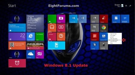

This will show you how to either remove or restore Run as administrator from the context menu of the default BAT, CMD, CPL, EXE, and MSC application files for all users in Windows 7 and Windows 8.
You must be logged in as an administrator to be able to do the steps in this tutorial.
EXAMPLE: "Run as administrator" in Context Menu of Application Files
Here's How:
1. Do step 2 or 3 below for what you would like to do.
2. To Restore "Run as administrator" to the Context Menu
NOTE: This is the default setting.
A) Click/tap on the Download button below to download the file below, and go to step 4 below.
Restore_Run_as_administrator.reg
Download
3. To Remove "Run as administrator" from the Context Menu
Remove_Run_as_administrator.reg
Download
4. Save the .reg file to your desktop.
5. Double click/tap on the .reg file to merge it.
6. If prompted, click/tap on Run, Yes (UAC), Yes, and OK to approve merging.
7. When finished, you can delete the .reg file if you like.
That's it,
Shawn

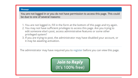

why I can not download the reg files
- - - Updated - - -
when I click download button, this page shows.
Hello, and welcome to Seven Forums. :-)
It looks like you were not logged in to the site at the time you tried to download.
Are you able to now?
