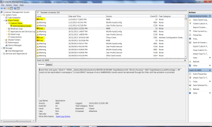

15. Study the Event Viewer>Custom>Admin view for repeat errors to google verbatim text and ID# to find out how others have resolved them. Event Viewer - Open and Use in Windows 7
For example: for the repeat errors highlighted below, googling the text will auto-complete showing others have searched for it, then take you to discussion threads which point to a MS Fixit for the problem.
