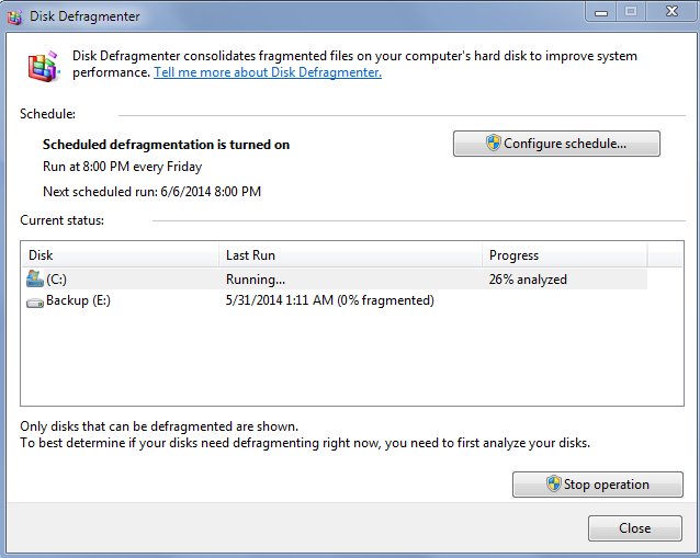

1.) Your Disks are Fragmented
The first reason is most likely due to fragmentation of your Hard disk or the virtual disk itself:
(This applies to vmware player and workstation as well as others)
   Tip
Linux Distros (ubuntu, zorin, etc.) do not need to be defragged due to the file system it uses.
Windows 8 and 10 names defragging as "optimization"
   Warning
Keep in mind, if you have a SSD (Solid State Drive) and the virtual machine or host has the files on a SSD Ignore the following below. Do not defrag an SSD ever.

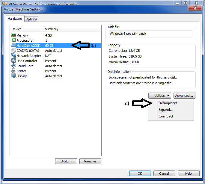

Defragmenting Virtual Disks:
Like physical disk drives, virtual disks can become fragmented. Defragmenting disks rearranges files, programs, and unused space on the virtual disk so that programs run faster and files open more quickly. Defragmenting does not reclaim unused space on a virtual disk; to reclaim unused space, shrink the disk.
For best disk performance, follow these steps:
  • Run a disk defragmentation utility inside the virtual machine.
    Click Start, :orb: Click Computer. Right Click Local Disk C. Choose properties. Under tools-Click Defragment now.
  • Power off the virtual machine once defrag is complete in the VM, then defragment its virtual disks from the virtual machine settings editor (VM > Settings). Select the virtual disk you want to defragment, then click Defragment.
       Tip
    Note: This capability works only with virtual disks, not physical or plain disks.
  • Run a disk defragmentation utility on the host (your physical) computer.
   Tip
Defragmenting disks may take considerable time.
Note: The defragmentation process requires free working space on the host computer's disk. If your virtual disk is contained in a single file, for example, you need free space equal to the size of the virtual disk file. Other virtual disk configurations require less free space.

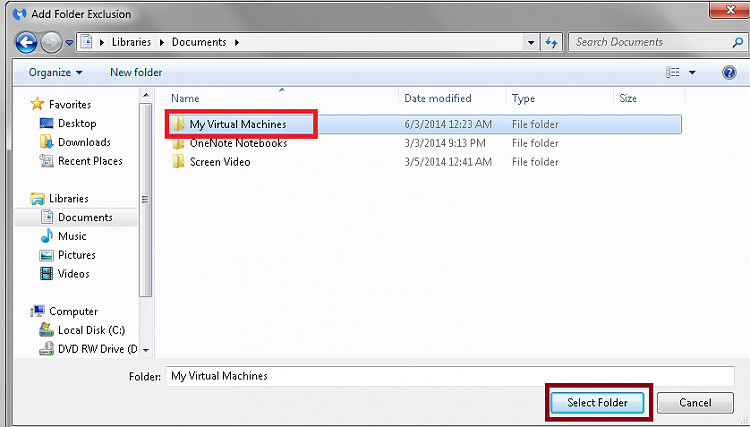

2.) Realtime on access scanners- Anti-virus/Anti-malware Utilities are scanning your Virtual Machines Folders while they are in use
When you are using your VM, you might run into slowness due to your antivirus or a program like malwarebytes scanning your virtual machine files on the host machine as you are using them, slowing down your VM. So what we want to do is add the folders where your Virtual Machine files are stored so that the on access protection software you have installed is not scanning the Virtual Machines folders and not slowing you down.
   Warning
If you do this, This means your anti-virus/anti-malware solution will not find infected files in these folders. Due to this, I recommend scanning the virtual machine folders every now and then by right clicking on the folder and choosing to scan with your protection software. You also may need to undo the exclusion before you are able to scan the folder.
   Tip
The following will be demonstrated with Malwarebytes pro as an example. You must read the documentation on your Antivirus product and any other real time scanners so you can find the Exclusions setting. It can be typically found in the settings panel for the program however.

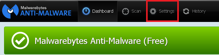

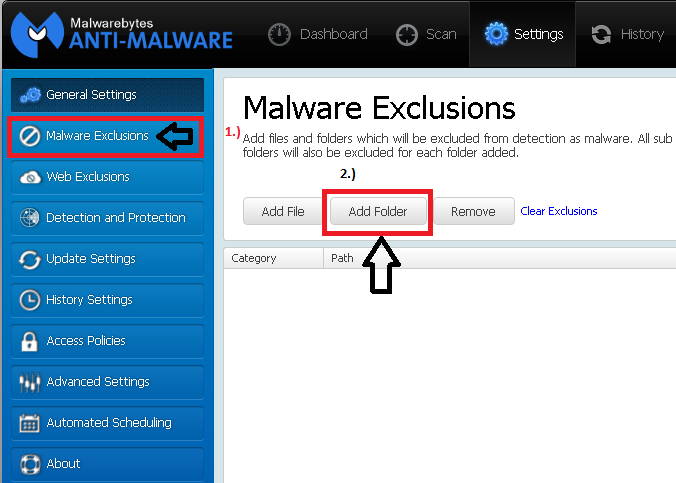

Text instruction: Open Malwarebytes. Click Settings. Click Malware Exclusions. Click Add folder. Choose the folder where all of your Virtual machine files are stored. Click Select Folder. You are done! Close out.

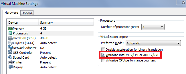

13.) You do not have AMD-v OR Intel VT enabled in your bios.
You want to make sure this is turned on in your bios, as it adds a lot of benefits in performance wise when using Virtual Machines. See your computer's documentation or Google your pc model for instructions on how to do this.
14.) You have AMD-V OR Intel VT enabled in bios, but do not have it turned on in Vmware Player.
If you have hardware supported virtualization, make sure your Virtual Machine program such as vmware player, virtual box etc is told to use it.
In vmware player, go to edit virtual machine settings as shown in step 1 above, and under the processor tab, choose virtualize intel vt-x/ept or amd-v/rvi and make sure it is checked.
See screenshot:

If I may, I think 'Disk cleanup' or 'Compact' should be the first step (while VM is shutdown) before defragging. Don't know what your opinion is on this.
