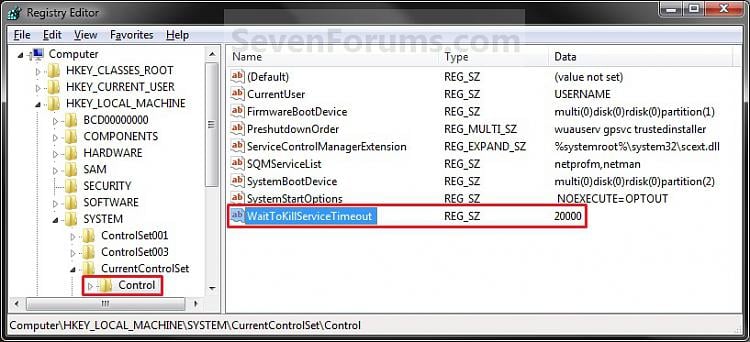

2. In regedit, go to: (See screenshot below)HKEY_LOCAL_MACHINE\SYSTEM\CurrentControlSet\Control
3. In the right pane, right click on WaitToKillServiceTimeout, and click on Modify. (See screenshot above)

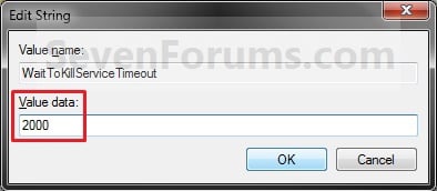

4. Type in a number between 2000-20000 (2-20 seconds), and click on OK. (See screenshot below)
NOTE: The default time is 12000 (Windows 7) or 5000 (Windows 8). I use 2000 (2 seconds) and have not had any problems. Your experience may vary.

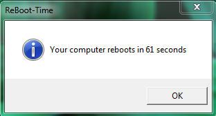

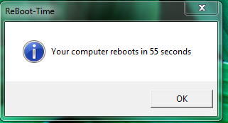

My boot time with waitokill value at 12000:
My boot time with waitokill value at 120:
