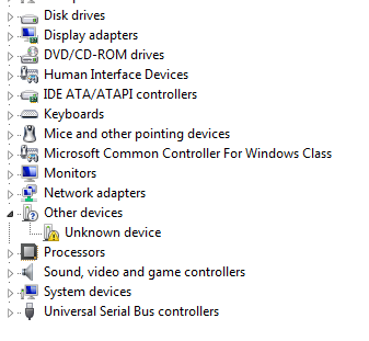

    1. Open Device Manager and find the device. It most likely has a yellow exclamation mark on it like the one in this screenshot below.
         Tip
      You can open Device Manager quickly by typing devmgmt.msc into RUN or SEARCH and pressing ENTER.
