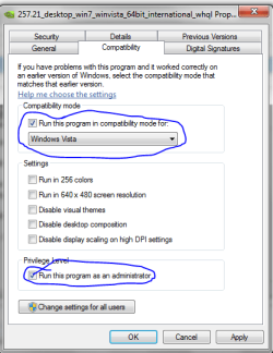

1. Right Click the Setup File and Click "Properties".
2. Click on the Compatibility tab.
3. Check the box marked "Run this program in compatibility mode for" and select "Windows Vista" from the drop down list.
4. Check the "Run as Administrator" box.
5. Run the setup file as normal, Hopefully Windows will now report itself as Vista, and will install the correct files.
