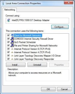

When you open up the Properties on the two connections (side by side), are they the same?
Example

Yup both are the same as your picture. When I plug the ethernet cable into the port that is not working it constantly says that a cable has been plugged in then disconnected.
