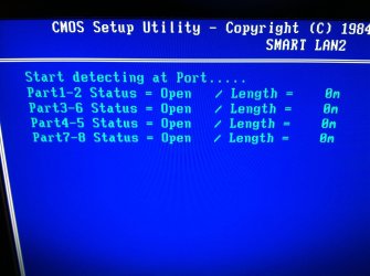

Your motherboard supports "SMART LAN1/LAN2 (LAN Cable Diagnostic Function)" in the BIOS ga-890fxa_ud5 manual (goto page 51) maybe you could use this as a diagnostic tool for testing ;)

I've tried a live version of ubuntu and it still wont connect through that either I have gone into the BIOS and disabled both connections then re enabled it again but it has not made any difference. So I assume that the port must be faulty? I have been in contact with Gigabyte and they have informed me that they offer a 3 year warranty on the board so at least I don't have to rush about sending it back. I just hope the other port continues to function okay.
Edit- I tried the SMART LAN1/LAN2 (LAN Cable Diagnostic Function) this is the result I get attached picture.

Yup both are the same as your picture. When I plug the ethernet cable into the port that is not working it constantly says that a cable has been plugged in then disconnected.

So what i have read your have tried the Linux with no Joy the Bois is saying the same old stuff.
Conclusion, Your Port has become damaged. Use the other port or do a RMA and get a new board sent to you.
