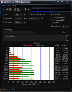

I flashed my U3S6 with the latest firmware from Station Drivers and it screwed everything up. Took about 4 minutes to boot. Went back to older version, same problem. Decided to go back to onboard SATA II port and the MSAHCI driver. The result is OK but this is the 2nd card that's failed on me. When I first got the speeds were incredible.
I was waiting on Bulldozer before getting a new MOBO but after this I might just bite the bullet and do it. Having said that, the drive performs great on the SATA II port.
