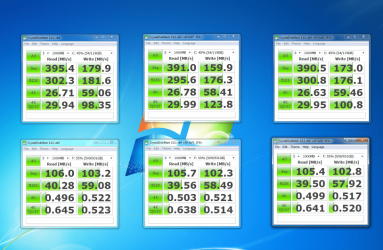

I have attached a screenshot of a result using Crystal Disk Mark.
The top row are the results of the SSD, while the bottom row is the results of my HDD. Although the results are considerably better than the HDD, I have been told that these numbers should be much better and the boot time should be very quick.

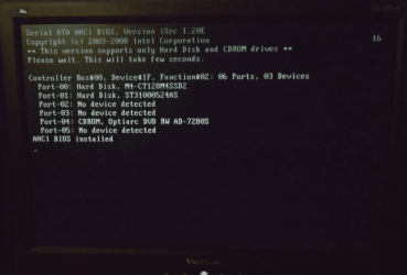

Okay, well I was able to get the BIOS to accept AHCI without a blue screen.
Unfortunately the boot time from BIOS screen to loaded desktop is 2.5 minutes. This is still a good 45 seconds slower than my HDD.
The ports are Intel controlled SATA lll 6.0 slots.
I did not run any additional r/w tests as you suggested and I am mostly working on the boot time now.
If I could get the boot time to be anything quicker than my HDD I would accept that, and then we can try to find out why the speeds posted earlier are still not where they need to be.
I am not sure if this means anything to you, but I noticed after changing the registry value and then restarting the pc in AHCI, there were two driver searches that just kept searching and never loaded. they were ata 1 and ata 2. I did receive the message to restart to complete the process, but I gave it about 5 minutes to see if it found those 2 drivers. I went to those two drivers in my device manager and asked it to search for the best driver (internet) and I was told that I had the best driver and the devices were working properly.
When I restarted the pc, I didn't get any errors or blue screens, or even another driver search....just two and a half minutes of waiting.

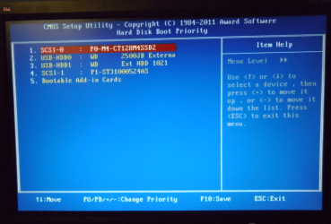

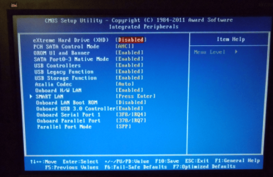

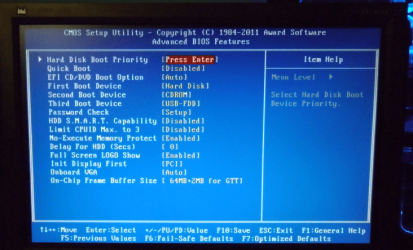

View attachment partitions.txtThanks for all the help guys. Although we still aren't there yet, I think progress...I really appreciate it.
I am attaching screenshots off several BIOS screens and I have attached a file with the results of the partition question posed by essenbe.
I hope these help and by all means ask away if you need anything else....I am just thankful there are guys out there like you willing to help.
Sorry the text document of the partitions isn't below, I think it is gonna be embedded within this text.
Rick

Your alignment is as it should be.

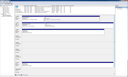

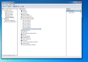

Thank You...here is what you requested

What do you have on your 1TB hard drive? Have you moved your user folders from the C drive to the 1TB drive?
I'm beginning to be at a loss here. One thing I noticed about your bios is smart on your hard drive is disabled, enable it. It can give you warning if a hard drive is developing problems. Download Data Lifeguard for DOS, the zip file contains an ISO file, extract the ISO or download the ISO version (Zip file will be faster download) burn it to a CD, the instructions are on the download page. Boot into the CD and select your Western Digital and run the tests. If you do not have your user files moved, shut down the computer, disconnect the western Digital and start the computer. You may have to restart a couple of times. See if you see a difference. You can do that even if you have moved your libraries, but windows won't like it because it can't find some files. You will get error messages, but it should be fine, I've done it several times. Also, right click computer, select manage, in the left column select disk management expand the window and adjust the columns so both the top and bottom are visible. Post a screenshot. There are several things here. They are in no particular order. Do them in any order you like. from everything I have seen so far, there seems to be no problem, I am just looking for what's wrong. Even the tests you have shown are a little below what they should be, but you should be much much faster than the boot times you talked about. I have 2 of the same drives as you. When you boot up, when you see the 1st loading windows message, start timing it from there. That is the first time your hard drive comes into play, the rest is your motherboard bios POST process.
If any of that is unclear, don't hesitate to ask. I or someone else will be happy to explain why or how.

I didn't add, remove, or change anything on my HDD, which was the C Drive and has now been designated as the F Drive.
I apologize, but I never updated my system specs after getting this computer. I have updated them just now. The HDD is not a WD but is actually a Seagate Barracuda ST31000524AS 1TB 7200 RPM 32MB Cache SATA 6.0Gb/s 3.5" Internal Hard Drive.
I would imagine that downloading and running the WD utility would make no sense at this point. Is there a utility for Seagate that might accomplish the same thing?
I have attached a screenshot of the disk management screen that you requested.
I set the SMART feature in the BIOS but I didn't see any difference in boot speed and I didn't receive any messages either.
Disconnecting and reconnecting the HDD had some interesting results. I disconnected the data cable, and restarted the computer from being completely off. It took 45 seconds to be at my desktop. I said this must mean something but what? So, I restarted the computer with the HDD still disconnected and it actually took 10 seconds longer than when it was started cold. I reconnected the HDD and started from cold. It only took 45 seconds to be at a loaded desktop. I was beginning to like what I was seeing. Unfortunately, the next time and three times after, when I restarted the computer, it took up to 3 minutes to get to the desktop.
The delay seems to be split between the BIOS screen, which flew by when the computer booted in 45 seconds but the longest delay by far is at the Starting Windows screen. It says starting windows for almost two minutes before the windows logo appears.
Thanks for your help

Actually, I was only able to boot quickly one time when the Seagate was disconnected. The second time while disconnected was slow.
After reconnecting, the first was fast and the second was slow...so I am confused.
I am not saying that the problem is not with the Seagate, although the SSD did boot fast once while the Seagate was connected.
I will try the Sea Tools and see what that shows.
I wasn't able to locate a download for the driver you suggested below:
Have you installed IRST? If not, you may try to download it from gigabyte for your motherboard. It is Intels Raid driver but also contains their AHCI driver IaStor
It seems worth a try along with the sea tools.
If you have a link to the proper driver that would be great.
Thanks Again!!

I haven't completed the Sea Tools test yet, or installing the drivers you suggested, but since it was a quick and harmless task, I decided to try something someone suggested which was to unplug both of my WD External Drives.
I disconnected them and on startup, my computer reached the desktop in 33 seconds. I clicked on restart and the computer reached the desktop in 30 seconds.
I do not believe that this is the entire issue, or should it be a problem to have Disks connected via USB. Also, since I leave my computer on all the time, I would rather settle for the 2.5 minutes boot time than to have to keep plugging and unplugging my externals.
Lastly, the performance of the drive is decent (SSD), but as you stated it should be better.
I will do the Sea tools and driver install this evening and see if that helps both with and without the External Drives connected. Let me know what you thinks.
Thank You!!!
