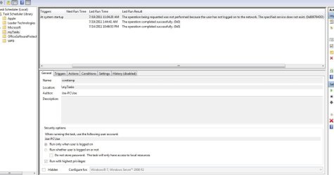

I created the task in the Administrator account, creating it in Standard wasn't working. A Network account window kept occurring, and entering in the regular password for windows wasn't working either.
After creating the task and the short cut it won't run. Instead a command prompt window flashes on screen for a second and that's it.

Hello Jerome,
This will not work in a standard user account. It will only work in an administrator account. :(
