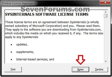

4) If this is the first time you used Permanently Delete, then click on Agree for the SDelete license agreement. You will not see this anymore afterwards.

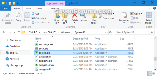

4. Move the SDelete.exe file into the C:\Windows\System32 folder. (see screenshot below)

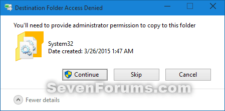

5. Click/tap on Continue to confirm. (see screenshot below)

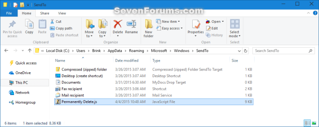

9. Move the Permanently Delete.js file into the shell:sendto (type in address bar of explorer and press Enter) folder. (see screenshot below)

1. Open the C:\Windows\System32 folder, and delete the SDelete.exe file. (see screenshot below)
2. Open the shell:sendto (type in address bar of explorer and press Enter) folder, and delete the Permanently Delete.js file. (see screenshot below)
