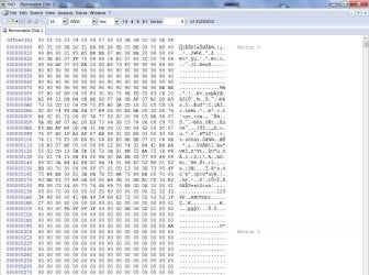

Making the Flash drive RAW:
Zero filling the first sector using HxD Hex Editor - turns the flash drive to RAW

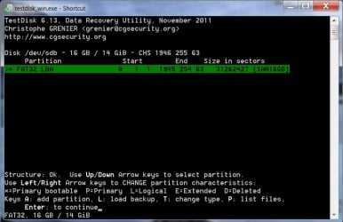

7. Partition identified correctly.

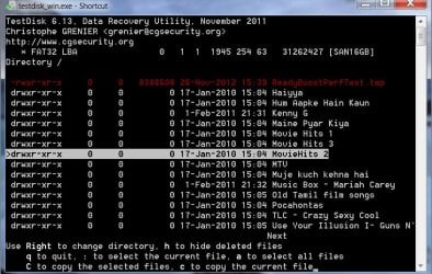

8. At this stage I pressed “P” to list the files and check whether it can see the files. It
showed all the files. I copied one file to a partition on my internal drive and checked
that it played. I terminated TestDisk after this since I have to now try Partition Wizard.

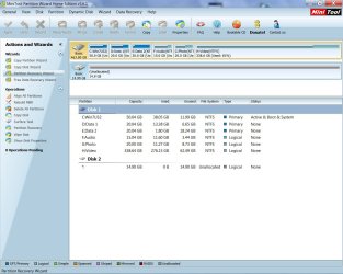

Run Partition Wizard 7.
The flash drive is shown as “unallocated” and without a drive letter.

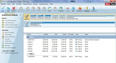

The Main Screen shows the restored Flash Drive but still without a drive letter.
Right click on the drive, click on Change letter and give a drive letter.
Click on Apply to execute the two pending operations.
The partition is restored and the flash drive is now functional and you can access the files and folders.
