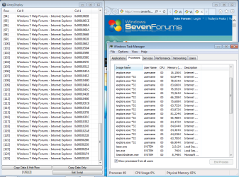

No, IE does not do that. Not even close.
Here is a screenshot showing 120+ IE8 tabs open:
Do you see 120+ IE8 processes running?

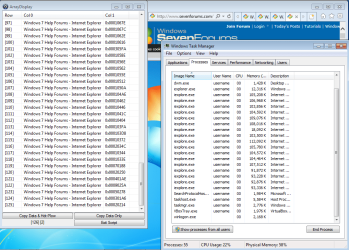

IE11 seems to only launch 16 children...
...no matter how many tabs are opened
...unless tabs crash and are recovered.

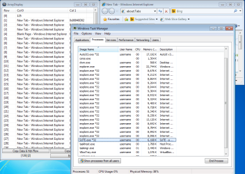

120+ IE11 tabs using 32bit children:
120+ IE11 tabs using 64bit children:
See this post and the tutorial above it to enable 64bit children.
edit: IE11 gets a bit wacky around 1100 64bit tabs on W7 with 4GB ram.

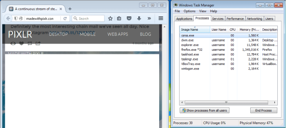

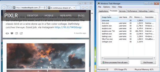

Firefox 43.0.4 stopped loading the images once I reached 2 months ago on that website. I restarted the VM (W7pro64bit 4GB RAM) and tried again. It took 5 tests to get 4 months back and FF was using 1.3GB. I used an AutoIt script to repeatedly click on the scroll bar. The same script was used for both FF and IE11 - clicking/scrolling/loading the website at the same rate. IE11 never missed an image. I stopped the comparison at 5 months back in IE11 and it took far less RAM.
Chrome 47.0.2526.111 (32bit or 64bit) has no problems with the images. It rendered them faster than IE or FF. But Chrome crashes most of the time on that website. It took 2GB of RAM to go 5 months back.
You can let me know how Opera handles that website :-)

If anyone likes to experiment with Firefox and don't want to use Nightly builds, you can enable this:
layers.offmainthreadcomposition.testing.enabled (set it to true)
browser.tabs.remote.autostart (set it to true)
dom.ipc.processcount (change the value to something rather than 1, I'm currently using 24)
Restart Firefox, and check in about:support that multiprocess windows says 1/1
The first two enable Electrolysis, but the last one enables process per tab ala Chrome, the bigger the number, the more processes Firefox will create (matching any number of tabs you may open), meaning 5 tabs = 5 processes.
The extra processes are called "plugin-container.exe", just as the normal plugin container process is created for plugin isolation (for example, when Flash runs).
Let's hope this is stable enough, I'm using this right now, the only issue I've found so far is that, when you increase processCount to more than 1 is that the print button in the hamburger menu, it doesn't work as spected, instead you need to use Ctrl+P to print something...
Happy testing :P
