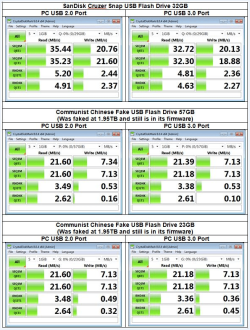

Hi Mr.Ed,
Those were some very informative videos you shared. I'm testing this drive for actual capacity now. It will end up taking a few days. This drive is slow like one of the videos says. I keep imagining that before the week is over, I'll be taking this drive apart to discover it's just 3 caseless usb sticks plugged into a caseless usb hub, with the circuit programmed to make Windows think it's 8TB when it's not even close. I'll update this at the end of the week. I still don't have a system tab in properties, but at this point it's not a concern. Thanks for your input on this.
In the beginning of the video he was going to return the fake 2TB drive for a refund from Amazon. However, some live stream viewers donated money just so he could take the drive apart and see what was inside. He started doing that at about 2:40:00 in the video. Here is a screenshot of what he found inside. At the bottom left apparently is a flash drive with a USB A connector. Black wires run from it to a USB C connector at the lower right. Your drive may have four of something like that inside.

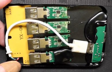

I took the unit apart. There is a 4 port hub pcb with 4 usb sticks. The 4 port hub pcb looks only has a few components on it:
1. 16pin chip that says
SL2 : 1A
USB 2.0 HUB
TT0119A21
2. 8 capacitors
3. 4 connectors for the usb sticks
4. 4 usb sticks (they have cases on them)
5. USB 3.0 input connector
6. Crystal that says 12.000
I connected one of the usb sticks to a USB 2.0 port on my PC. Windows explorer says it has a capacity of 2TB.
I'm now copying data to it to test it.

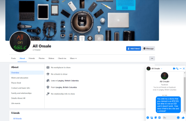

Here's a picture of the Facebook profile for the guy who sold me this great drive.

Here's a picture of the fake drive taken apart.

Here are my Crystal Disk Mark results.
If you notice in my results the USB flash drive with a USB 2.0 interface showed about the same results whether plugged into a USB 2.0 or USB 3.0 port. That makes sense. However, when a USB flash drive with a USB 3.0 interface was plugged into a USB 3.0 interface the results were faster than when plugged into a USB 2.0 interface. That showed this flash drive was able to take advantage of the faster USB connection.
Your results were the same for both USB 2.0 and USB 3.0. That means the flash drives were probably USB 2.0.
One consolation is that your fake flash drives have a faster random write speed than my PNY 64GB USB 2.0 flash drive.
