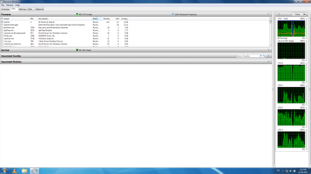

As for a screencap, I had to wait for it to happen again. Here you go:
It seems to be the System and System Interrupts, which AFAIK, is in charge of drivers and the like.

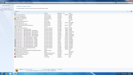

The only program left that could possibly be trying to phone home is Daemon Tools, and I know it's not. I disabled the "Check for Updates" and "Send Statistics". Beyond that... I am unsure of what could be. When I said I stripped this PC of most apps, I meant it; this is all that's left installed:
Do any of them seem like it could be the guilty party?

hi...
.adobe/daemon/mozilla/vlc will Highly likely be phoning home
unsure
acer launch manager/MS xna/winrar

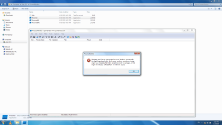

re Procmon ---- possibly the culprit... as its failing and likely retrying
run sfc /scannow
from an admin command prompt
chkdsk/r
and from the ms catalogue (you can download it via another comp to usb and run it from that)

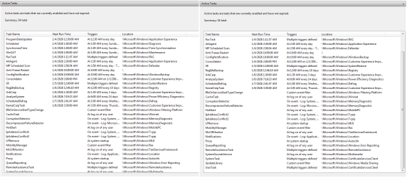

OK, center window in Task Scheduler shows these tasks active. Do any of them looks suspicious? (The one called anti-freeze is my own temp fix for this issue, which is to make the PC restart itself every 24 hours)
As for the running tasks, it was only this three:
No idea what they are.
Where would I find that "re Procmon"?
