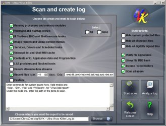

This is a strange one. I still believe that it's software related rather than malware. If you like you could perform a more in depth scan using UVK with the following scan settings applied:
Note:
Don't choose to hide microsoft files.
Change recent file search to 45 days as it covers the period when the problem started. The recent file search part of the scan only looks for executable files.
Upload the log to Dropbox and PM me the link to download - unless you have no privacy concerns and wish to post the link in your reply so that anyone can download the log.

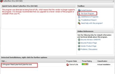

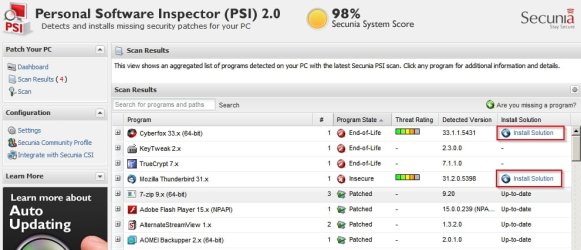

Okay well I've seen the same issue on my machine and it wasn't down to malware. It was down to buggy unpatched software and shell extensions. The problem is that it can be tricky to pin down.
Anyway there are a few things to try. Start off by checking for software updates. I'm going to PM you a link to download Secunia PSI 2.0 - it will check most of your installed software to see if there are updates available and provide links to download any missing updates. It's better to use Secunia PSI 2.0 rather than the current version as it gives you more control over updates and doesn't run in the background at all times.

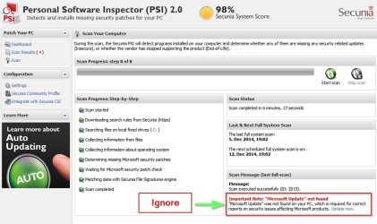

Once installed it should start a scan automatically. Also check the following settings and apply them.
Ignore this warning - it doesn't apply to Windows 7.

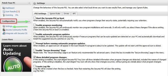

Click the arrow next to "Configuration" then click "Settings" and apply the ones shown below:

When the scan is complete apply any updates one at a time by clicking on the "Install Solution" link.
If a reboot is requested at any point - reboot then continue with another scan.

Trying to do "Install solution" for some of the programs but its not working at all any ideas? when i click on the application downloaded nothing opens up

Is should open the dowload link for the program update in your default browser. What is your default browser?
Try exiting Secunia then:
Start> Run
then type:
RUNAS "C:\Program Files (x86)\Secunia\PSI\psi.exe"
Then it will run with admin rights. Also check your AV/ Firewall to see if it blocked anything.
