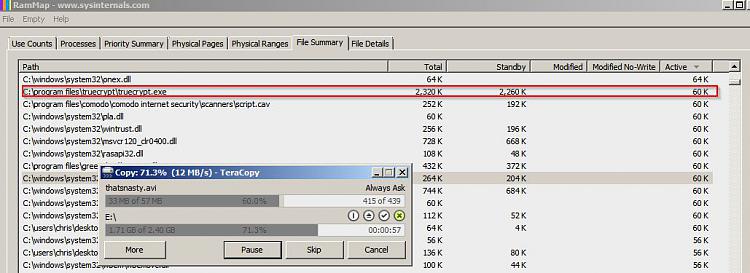

Copying a 2.4 GB folder. Memory used is steady at 2.03Gb (usage is usually 1.69Gb with only background programs running)
Nothing shows up anywhere in RAMMap as using an increasing amount of RAM.
That's probably not much help.

RAMMAP shows that TC is hogging a lot of the RAM, but what to do?

Since I don't have the problem it's hard to say. If you copy some files and look at RAMMap "File Summary" tab sort highest at top and see if TC is listed. Try looking at how many open handles the TC process has open. There are a couple of settings on my machine that I have changed in the past and I will look at them later. Currently I'm using a different machine.

When you use RAMMap (when copying files) what does file summary tab (Active) show is using RAM? Window needs to be refreshed (F5) as RAM usage increases.
