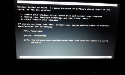

This is my first post here. I have a HP laptop that came with Windows 7 Home Premium 64-bit preinstalled. Very long story short I tried to dual boot Windows with Fedora 15 and I definitely screwed up my partitioning. My first stop was LinuxQuestions.org which pointed me to Seven forums. I've been trying to get this fixed for about 2 weeks now. When I try to use the System Repair CD it doesn't show my Windows Os as being installed. When I just let the computer load from the hard disk itself I get the 0xc0000098 error.

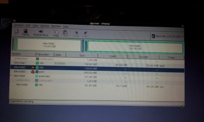

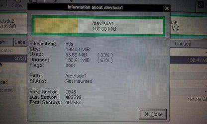

On a whim I decided to put in an old System Rescue cd to see if I could see anything about the hard drive. Surprisingly it loaded and I was able to use GParted to look at the disk. The MBR is on sda1 which is unmounted. When I hard Fedora 15 installed I was able to mount the disk, but when I would restart the system it would unmount itself.

Unplug all other HD's and peripherals, update your BIOS if it has an available update. If not reset BIOS to defaults Clear CMOS - 3 Ways to Clear the CMOS - Reset BIOS.
While in BIOS setup set SATA controller to AHCI mode to try install, IDE if that fails.
Set HD first to boot in BIOS setup.
Now trigger the USB flash installer by tapping the HP ESC or F9 one-time BIOS Boot Menu key at boot, select USB, Removable or HD to locate stick listing, boot stick. If you need to rescue any files proceed with Copy & Paste - in Windows Recovery Console . If not At first boot screen press Shift + F10 to open a Command Line, run Diskpart Clean Command.
Now follow the steps in Clean Reinstall - Factory OEM Windows 7 to get a perfect reinstall.
If problems persist post back the exact step where it fails and any verbatim error message.
Thank you so much for your help! The reinstall went perfect. Now I'm going to try dual booting again, but after I have everything properly backed up.
