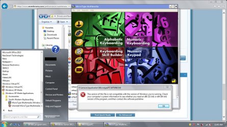

I have never seen a Windows 64-bit OS run a 16-bit program natively. When I run a 16-bit program, I get an error message like in the screenshot below. To run my one of my old 16-bit programs, I use Windows XP mode.
