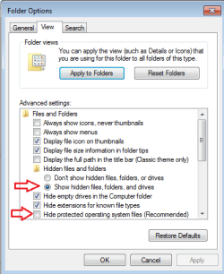

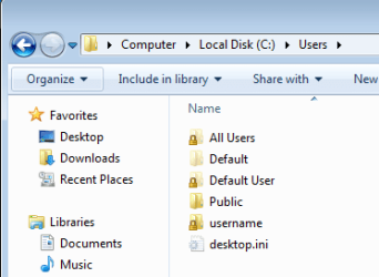

If you only see two folders
(similar to this):
Then please follow the steps here:
http://www.sevenforums.com/tutorials/394-hidden-files-folders-show-hide.html
For step 2, also uncheck Hide protected operating system files:
Then the Users folder should look more like this:
If there are no odd folders in there, then let's wait for others to post ideas for you.
You can set the folder options back to the way that you had them - if you wish.
(similar to this):
Thank you for your help so far! :)
I just checked the user folder again just now, using the instructions you gave me, and I still didn't see a user folder with the name of the 2nd account shown at the login screen on my computer.
