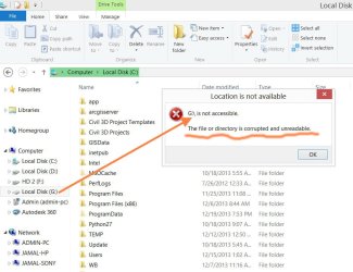

As I try to access my 2TB hard drive I got the message that says that the hard drive is inaccessible (attached). What is weird that this happens while I was accessing it and editing one of my Word files. No physical damage has occurred at all.
What might be the issue here?
Thank you

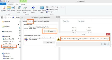

The issue here is that the disk not accessible. No commands are working. Please, have a look on the attached screenshots.
One option is left (as matts6887 has already advised) booting with windows and repair
What other options can I still have?

Please follow the steps in order that I gave them.
What are the results of the HD maker's HD Diagnostic extended CD scan?
If the HD will not test or run a Disk Check then try reinstalling it, replacing its cables or replacing the HD.
I agree here. It sounds like for some reason the hard drive just all the sudden went "dead"; possibly because of old age maybe? how old is the drive? Also as greg mentioned; you could try replacing the cable for the hard drive and see if that resolved the issue. If not the drive is probably as much as i may hate to say it; possibly a goner.

I would still also give the repair computer option by running the repair option off the windows disk a shot. IF that does not do anything to resolve it then the drive is probably a goner.

Many thanks guys for the help,
My 2TB drive is really new (less than one year in operation) of WD brand (my passport). Due to the fact that I have its back up with one day work loss, I preferred to format it. I did and it works fine now as if nothing happened.
My concerns here is that “data loss” is possible at any time without having simple tools for end users to get it repaired. I think that Windows should provide much more powerful tools to face this challenge. There is no value for our life if our data can be easily lost. Our data is our time and then it is part of our life.
