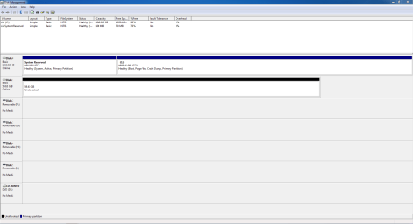

In addition to all this, I have a 100MB drive D: named "System Reserved" which does not correspond to any physical drive AFAIK. I never had that before tonight when the only way to boot was to install Windows on my SSD.
So now, none of my programs, games, etc. work because they are all on drive E: (my 2TB former boot drive c) and they are supposed to be on drive C:. I need to find some way to straighten this mess out without losing all my data. Also, as info, I have never overclocked anything on this machine- everything is bone-stock.
Does anyone have any advice as to how I can fix this so I have ONE bootable installation of Windows, on my 2TB HDD, and use my SSD as intended, i.e. as a cache to speed up my normal HDDs, instead of as my new system drive with no room for anything else?

Disk Management Screenie:

Disk management screamshot posted in OP above.

Yes, I meant physically disconnect them. Your SSD seems to be DISK1, but the boot manager appears to be in the 100MB System Reserved partition on DISK0. This happens when 2 or more disks are physically connected during installation.

And yes, that is my SSD showing as Disk 1. The 2TB drive that is supposed to be my boot drive is Drive 0. According to my research, that's the correct way to connect them to function as I want them to function, i.e. the 2TB as main HDD, and the SSD as cache only using Intel Smart Response.

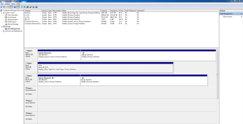

Thanks for all the help. I was able to successfully re-install Windows on my 2TB drive, then reconnect and clean my SSD. Unfortunately, despite following the steps one by one as given in the linked Clean Install tutorial, the 2TB drive still has a 100MB System Reserved partition, and there does not seem to be anything possible that I can do to enable Intel Smart Response technology- I have spent 9 hours now online, reading, researching Intel Rapid Storage and Intel Smart Response, to no avail. It worked great until the system crashed, now I can't make it work at all, including deleting the SSD partition, formatting it, deleting it again... every website seems to have a different strategy, and Intel pretends nothing could ever go wrong so they don't address the issues at all.
Here's another screenie of my Disk Management window in case anyone has any ideas.

You made a right royal mess of it all but not to worry since you have your data backed up no harm done just more experience gained. So here is an idea that should make your life simpler and still have fast computer just buy another SSD maybe 128 or 256GB if you can then install Windows on it using AHCI or RAID mode and again only have this drive connected while installing make sure it's optimized and then connect the other SSD, format it as ntfs and use it for the Pagefile and to move user folders into it such as Music Pictures etc. Then connect your 2TB format it and use it as the storage drive. It always surprises people how much faster the SSD drives are and it seems a lot less of mucking around and hours of searching for no result (At least so far) and I'm sure you have better things to do than spend days and weeks chasing it unless of course it's what you like doing. Otherwise wait for a more qualified person here to suggest other ways to fix it if your Windows installation is otherwise OK. Oh the 100MB partition is supposed to be there so leave it alone

It would be expected that the installer would issue the 100mb System Reserved partition as explained in Clean Install Windows 7 which is perfectly normal and not at all undesirable.
The SSD is not formatted in the screenshot. Did you try the steps in ▶ How to Set Up Intel Smart Response SSD Caching Technology | PCWorld to RAID the SSD with the HD?
If nothing else works you can either move the paging file to the SSD to test performance that way: Virtual Memory Paging File - Change - Vista Forums
or install the OS and primary programs to the SSD, move the User folders to the HDD User Folders - Change Default Location
Then if you still need to conserve space set the paging file to 2gb only, install lesser-used programs to the HD. 60gb is rather small for an OS drive, but we've helped users install to the 32gb SSD chip on an MSATA drive before so we know it is doable.
Yes, I followed the PC World setup steps. The SSD was formatted for my first few tries, then I cleaned it and deleted the partition for my final attempt. I do not want to install the OS on the SSD, that's where I was earlier. I want the SSD to use Intel RST/SRT and cache my HDD as it did before the crash. My SATA controller is set to RAID in BIOS. Other than that, I don't know how to "RAID the SSD with the HDD." Thanks.

Interesting development: I decided to remove the 100 MB System Reserved partition on the 1TB HDD. As soon as I did, it instantly changed to a raid disk all on its own! So now I have that drive and the SSD both RAID disks. Of course, it's the wrong HDD. But now it seems clear that what is preventing the 2TB drive from being a RAID drive is the System Reserved partition. Anybody know how I can merge that partition into the main partition without losing my data on that drive? Will Partition Magic or some similar utility do that?
