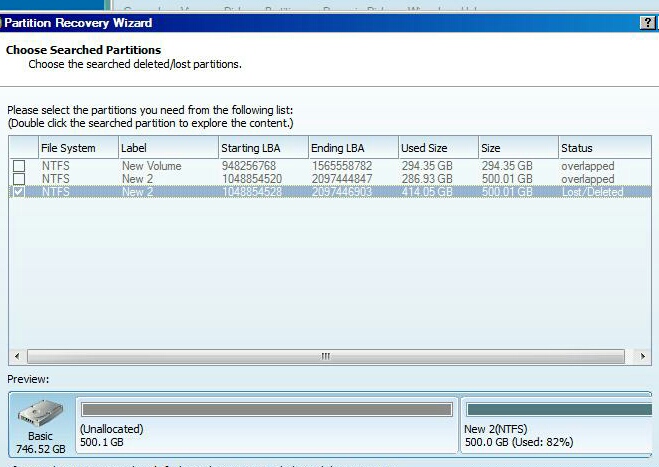

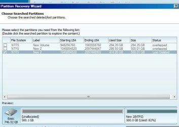

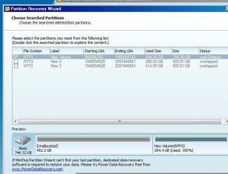

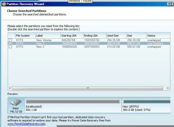

Seagate 3TB (ST3000DM001) in a Thermaltake BlacX (USB+E-Sata) docking station that had 5 partitions spread over the actual drive's capacity, now registers as 746.5GB unallocated.
I connected the dock to a Win 7 desktop through E-Sata and copied files off of the external successfully. Shortly after I plug it into a Vista x64 laptop (machine it has been used with predominately and problem free) and I get back to business. A few minutes later I notice the partitions aren't visible/746GB unallocated.
Disk Management, TestDisk, PhotoRec, Partition Guru, etc all display 746GB instead of 3TB. The Vista laptop is the only machine I have access to at the moment so the scans/tests are being done with that. If detecting the 3TB (so I can then recover all the partitions) necessitates a system/interface change, that can happen.
Can see the files on this partition
No files on this one

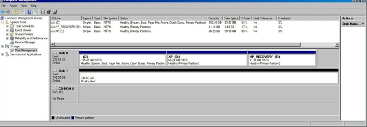

OK, I would like to see the 1.Windows Disk Management on your Vista machine. ( Please plug out any other external drives connected to the machine and only the 3TB HDD on the Dock) 2. The first screen when you run Partition Wizard.

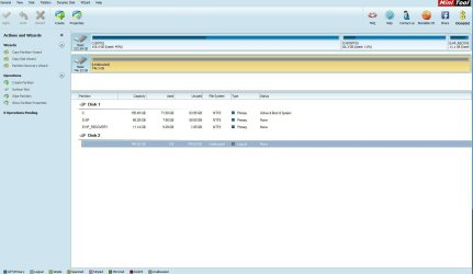

1.windows disk management on your vista machine.
2.the first screen when you run partition wizard.

Ok, the only thing I can glean and happy about is that the Partition Wizard does not show your external drive as Bad Disk. That is good.
Other than that there is not much to say about the two screenshots.
