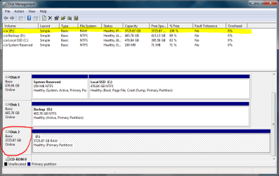

Taking a look at Drive manager shows the drive has a 'full' 4TB of space

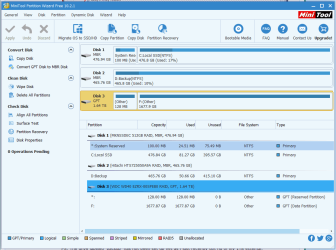

However, upon using MiniTool Partition to do a scan (as well as in TestDisk console tool) They only show about 1.64 TB max space.
Note: The drive is GPT rather than MBR. Even MiniTools detects that much, yet still only shows a 2TB partition.

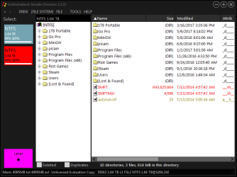

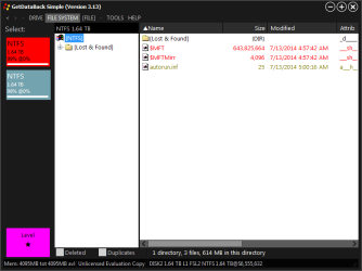

UPDATE: I've been able to verify using GetDataBack that my files are still intact
That's just the 'first partition' (the drive was never actually partitioned before this happened)
The second 'partition' doesnt really have anything on it...at least nothing I would deem important.
Now how to go about recovering this data?

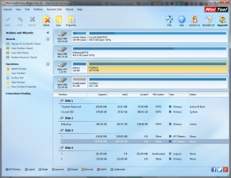

c) I did post a screen shot, that would be the third picture down. It only shows about half of the max capacity.

"I did post a screen shot, that would be the third picture down. It only shows about half of the max capacity."
That was the Partition Recovery Wizard Window. What I wanted to see "Post a screenshot of how your drive looks like in Partition Wizard - the very first screen when you launch the application

Very well, here is the screenshot of the drive...though it shows the same thing as my third picture in the original post...only half the drive.

What you see with your eyes and what I see with my eyes(+brains - if I have one.(My wife always has this doubt) :D) can be quite different. How is that?
Try doing this now.

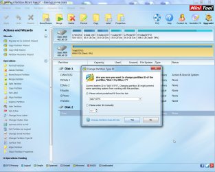

In the Partition Wizard screenshot you posted your drive F: shows as (Other). Right click on that partition F: click on Change Partition Type ID and change it to NTFS. Click on Apply in the Top Menu bar if needed to effect the change.
If after making it read NTFS also your drive is not recovered, then you have to use TestDisk to replace the corrupted volume Boot sector with its backup if the backup is found OK,

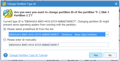

When I try to change partition ID I am brought to this window
It is slightly different from how yours is displayed (different version)
The problem is...NTFS isn't an option. What I have to choose from are
MBR Partition Scheme
EFI System Partition
BIOS Boot Partition
Intel Fast Flash Partition
Sony Boot partition
Lenovo Boot partition
Windows-Basic Data partition
Windows-LDM Metadata partition
Windows-LDM Data partition
Windows-Recovery Environment
Windows-IBM GPFS Partition
Windows-Storage Spaces partition

Let us go with a known devil.
Uninstall PW 10/10.1/10.2.1 and install version 9.1. Download from FileHorse .Have a look at my post #2 here External HD - Partition Unallocated
Windows 7 Home Premium 32 bit
Installed 9.1 ...I no longer have the option the change partition type ID ... on that drive.

OK, I tried both PW 9.1 and 10. When the disk is GPT it does not allow partition Type ID change.

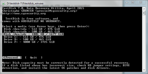

Let us see what TestDisk finds. Make sure you have installed TestDisk 7.0
My post #13 here External HD - Partition Unallocated
Follow the process outlined in my post #19 there with appropriate changes mentioned below.
1. In Screen 2, select your 4TB internal disk. Does your 4TB disk show as 4TB ? Post a screenshot.
2. In screen 3 Select [EFI GPT] since your disk is GPT
3. In screen 4, when you select [Advanced] and press Enter what is the next screen that appears? Post a screenshot.
TestDisk is highly interactive and so I cannot predict and we have to make an appropriate decision based on what the screen shows.
Okay so a little hung up here....
/dev/sdc and Drive F: are physically the same drive. Though the first shows only half capacity while the second shows 4TB.
Which do I chose? Or maybe more so, why is it displaying like that?

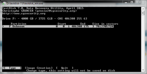

Things do not look any better.
Select/Highlight Drive F: [Proceed] is highlighted. Press Enter
[None] - Press Enter
[Advanced] - Press Enter.Post the next screen.

That's not something I like to hear.
Win 7 Ultimate 64-bitIntel i716GB Corsair VengenceGigabyte
Intel i7
MSI MPower
Gigabyte
hmmm............. that is the best it can do. You can change the file type to NTFS and then it can list all the files in the disk for you to recover. The change however is not written to the disk.
How to make it stick is a million dollar question for which I have no answer. So no million dollars.:cry:
