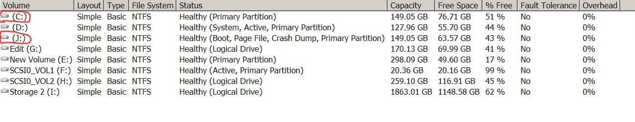

The fact that your system does not boot when you disconnect the other HDDs suggests that the bootmgr (active partition) is sitting on one of those disks. You can check that in Disk Management.
But that would not explain the Kernel_Power Event 41. That is a different problem hard to diagnose from here.
So far as active partition, I've included a screen shot from the Disk Manager, with two drives circled. C is the original Win 7 drive. J is the supposed clone, possessing all the contents of C from an earlier date. C is no longer "Active". J is but the computer won't accept that as a boot drive.
This screen shot was saved to C drive, not J, so the comments concerning where stuff is loaded applies here as well. Drive D is where XP resides, as dual boot which still operates correctly (Thankfully!). The rest are storage, except for F which is exclusively Scratch for Photoshop.
So, I will most likely reinstall over the weekend. I still wish I could simply run J as the boot drive and be done with it!
