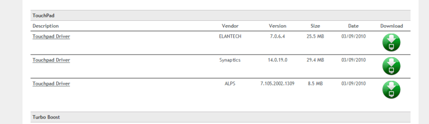

I determined that the touchpad in the replacement top cover was from Elantech. Even when deleting the Synaptics drivers under "uninstall programs" and deleting the driver in device manager along with the "PS/2 mouse" the device ID code implies that the hardware manufacturer is Synaptics. I downloaded the "Acer" versions of all three manufacturers' drivers from the Acer support page, then extracted them all to separate directories. I then installed and uninstalled them all.
The key was to use "Update Driver" from within Device Manager to get them to properly install. Don't unzip and try to use any of the files in the directory to install the drivers. That was hours of my life I'll never get back!

Longs2517,
I had exactly the same problem. Like you I uninstalled and installed Drivers from different locations. My computer was repaired under warranty and when it was returned I had the problem. I called eMachines (Acer) and they suggested restoring my computer to factory settings. Not a chance.
I was convinced the wrong hardware had been installed (it was Synaptics) but had't got as far as you.
Any way uninstalled the software and driver, downloaded the Elantech driver. I did unzip it and installed it and......... it all worked normally again so I could now disable the annoying tapping.
Thank you and well done. I will be in touch with eMachines shortly!
