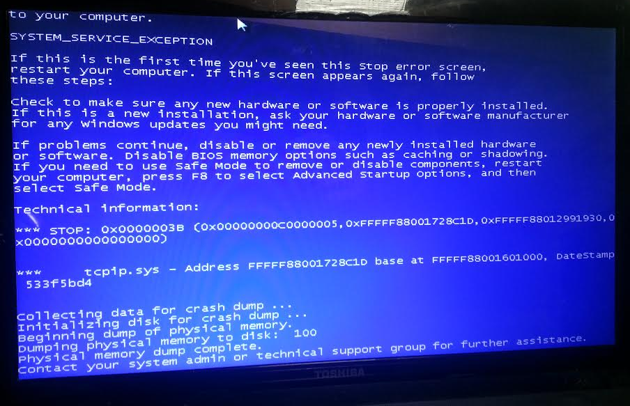

I attempted to install iata_enu.exe from the link you sent me, however this error came up after it loaded up InstallShield:
Another note: I do not have an Intel Motherboard or Intel Graphics. (I filled out my system specs below, if that helps).

UPDATE:
So I left my computer open while I took a short nap, and I woke up to see this:
I hope the image is clear enough to see the numbers and text well.

I think the BSOD is unrelated - but we'll come back to that later.
The fact that the files appear not to be present at all is worrying, since they should have showed up in the SFC scan as missing, and SFC should have at least attempted a repair..
I'll post a fix protocol a bit later.

FYI - tcip.sys is usually a networking issue (perhaps the network driver needs updating), but leave that till the updates/activation sorted first as Noel suggests.
