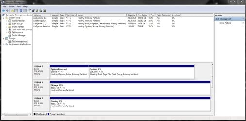

Can you post a picture of disk management
I'll give that a try Paul.
Here's the disk management.

That looks all very good. The problem is a real mystery.
